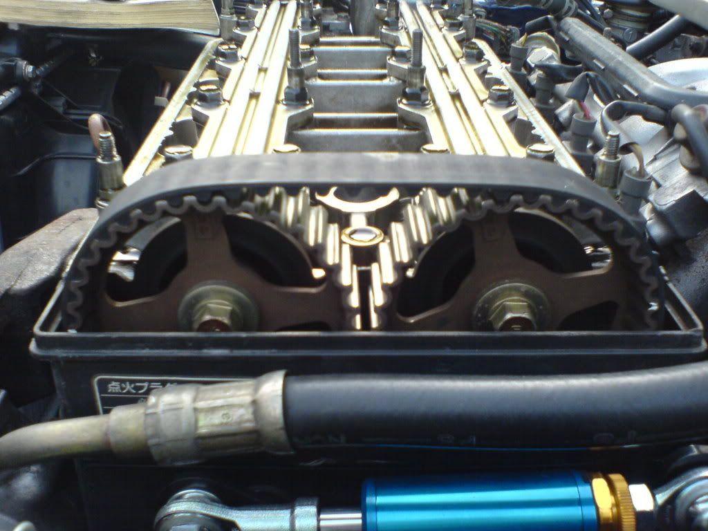

Right, just checked the cams, and I think they are right? Marks seem lined up but cam "up" points are not both exactly "up"??
Photos below:

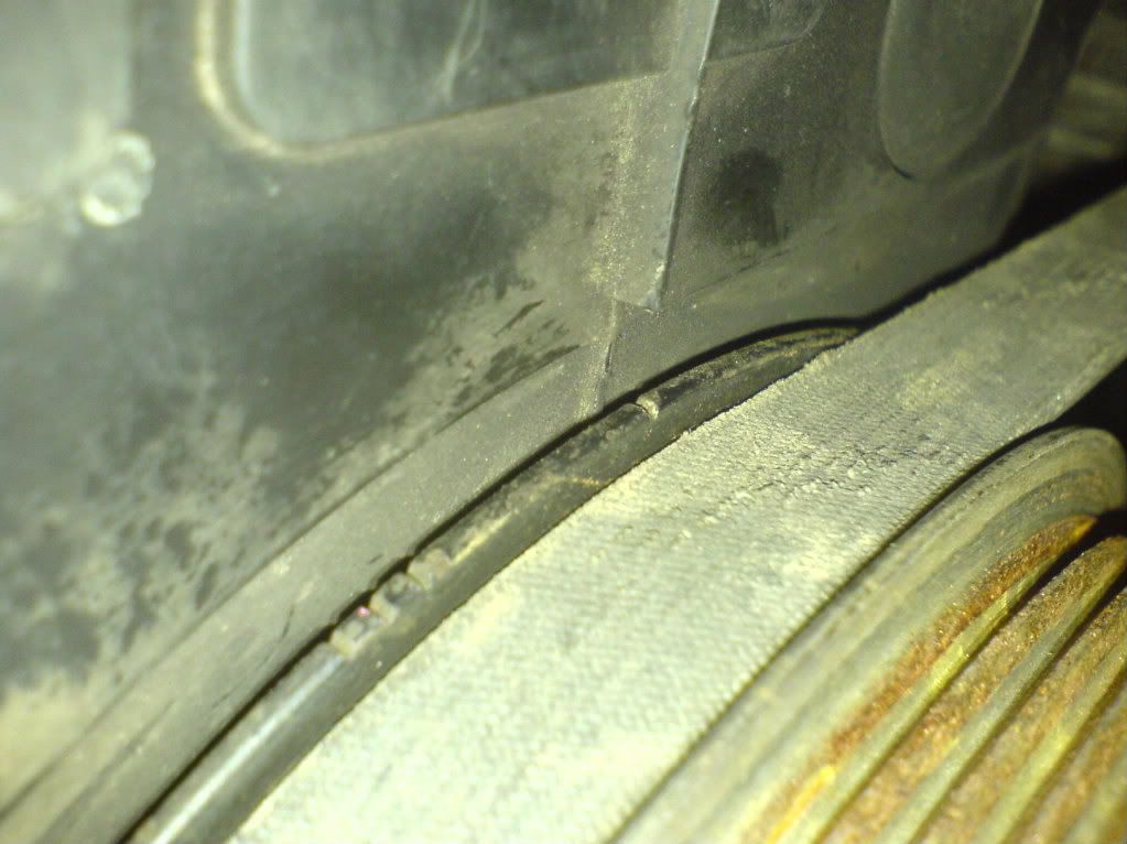

Pulley at TDC:
Cams:
Cams up close with marks visible
What do you think??
That intake cam looks to have gone one tooth off. On the pic, it looks one off, anyway. Does it look straight up? One tooth can make a large difference at high rpm, where the timing distance is more critical. Many cars can be slightly off timing, idle smoothm, pull fine in the low and mid ranges, but suck at top end. check to confirm this, again, as it looks off by the picture.
Post back and let us know. In the mean time, you could pull the spark plugs and check them, pull the cap off the distributor and check that and the rotor. make sure those things are somewhat clean, and no burn spots or anything on the rotor metal or cap metal contacts.
I also agree that the intake cam looks off by a tooth, I thought that before even reading matt's reply.
I think you should check your compression every time you change your oil if you run your motor hard. It doesn't take that long to do and its cheap insurance. This helps if you know how your engines compression normally check out, you'll be able to spot a potential problem easier. With that cam possibly being off a tooth it would also show on a compression check, as your numbers would be slightly lower for no other explainable reason. Usually compression numbers rise as an engine ages... to a point. Then they dwindle back down as the rings begin to stick/wear out.

x2. up doesnt look like its exactly up.
werd, what they said.

Right, I'm an idiot. For the photos I posted before I did not have the engine at TDC on Cylinder 1! I set it using the dizzy yesterday and the intake cam was definitely out by a tooth(photos to come).
So, following a friend's advice, I removed the cam covers & retainers, and tilted the intake cam just enough so that the belt was on the edge of the cam gear and I could turn it one tooth - without having to releast tension on the belt or remove the pulley etc etc.

With engine at TDC Cylinder 1:
After I changed it:

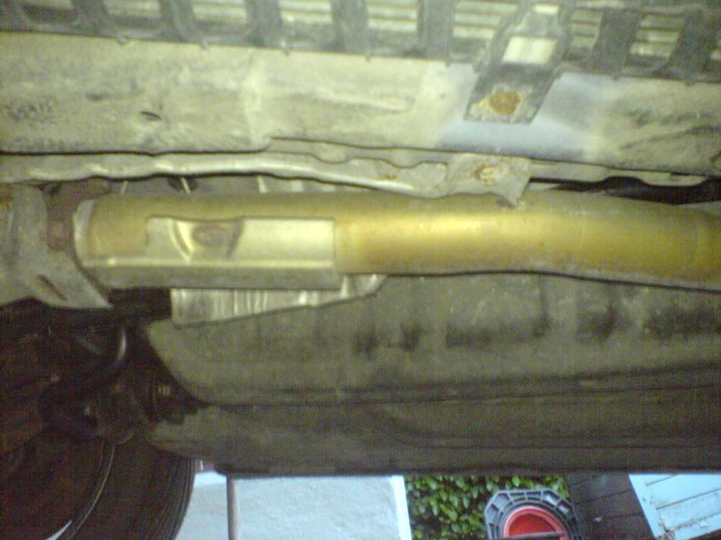

Oh, and this is the exhaust, looks 2" or 2.25" to me but I don't have a Vernier Calipers to be sure. Its either EK4 or EK9. I'm thinking EK4 as it looks more like 2".
Clearly not a difference that would loose big power but be nice to know:

Timing belt looks a little loose, but the cam does look closer to be lined up.

As for the exhaust, the difference between 2 and 2.25 is barely noticable, so I wouldnt worry about it

My cat is likely to need replacing also. I'm picking up an EK9 center section for fairly cheap this weekend - they are 2.25" diameter - not a huge difference but for the price I'm getting it it's worth doing. I'm also going to see if it will allow me to use a JDM DC2 ITR cat that I have (shortest OEM cat, & has a stupid big flange!)

On the exhaust, ... just thinking that the 2" exhaust is probably helping my low-mid range torque...
