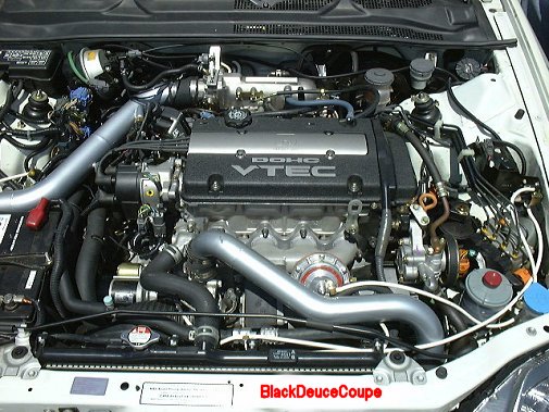

Can we please stop this foolish MYTH? We're not talking Cummins Diesel. Here's what a H22A swap looks like:
Does this look like it's going to "be hell on your front end"???

Oh my god! It's so huge! How can that engine bay possibly contain it! The H22A will destroy us all! AHHHHHH! :eek:

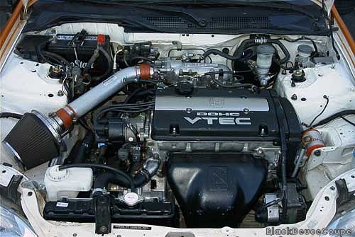

As far as the turbo goes, that's NO problem. Here's some more pix. Look at how much room there is in front of the header area:
The yellow car is LJ's ride. Before everyone jumps my sh!t; yes I know it has a BOV and no turbo present. He added a turbo and nitrous since this pic was taken.
"Does this look like it's going to "be hell on your front end"???"
Looks like Heaven to me!!!!!:)
