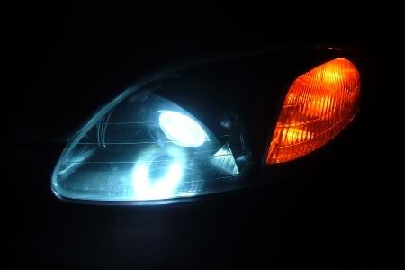

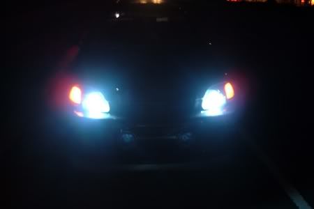

I haven't got a chance to take pictures of them until today ^^I love them except it's too blueish - I ordered 7000k but that dude sent me a pair of 8500k.. :bh
A6 bi-xenon projectors $100 from Ebay
Megatune 8500k D2S bi-xenon HIDs $350 from Ebay
OEM civic headlight housings $120 from Ebay
Shrouds $30 from Ebay
Wire Harness w/ relay $15 from RadioShack
spray paint $9 from Kragen
price above is included shipping and tax
any comments r welcome ^^

kick ass man, looks nice and clean :btu

Yeah I think someone needs to make a sticky:
HIDS
More numbers does not mean brighter.
4300-5000k are the brightest HIDs. This means they show more of the road and in my opinion make them the best.
anything ABOVE 5000 is less light and more of a ricey tint...
But those retrofitted projectors looks decent. A buddy of mine has the same setup on his 2000 Civic Si

I have OEM 4100*K Phillips burners in my setup. If the projectors arent colorful enough bend the sheilds. ;)
I love the way mine look. The cutoff is dark blue (bent e55's) but the output is pure white. Super easy on they eyes and non-glaring.
I love retros!

damn those headlights have to own people when your going down the road. badass. i really like the purple with the c/f hood. looks good. do you have any full pics of your car? post up or teh ban :D
