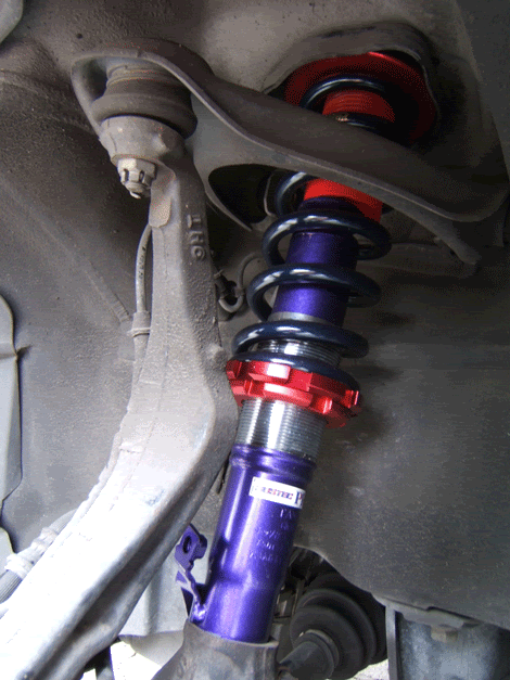

I just got new suspension installed in my Lude. I got Tanabe Sustec Pro S-S.
I dropped the car to 1 inch ride.
Enjoy

ooo thats real pretty...how much did those cost ya and how does it ride/handle? sweet ass engine bay too, thats about as clean as it gets :number1 props man

Also I LOVE the coilovers. Tanabe recommends wrapping the threads with teflon tape, this preserves the thread so it doesnt get dirt in it and also prevents water, grease and rust. Another thing is the dust boots might have to be trimmed a little .. so lower it to the ground and make sure they dont extent too low. Tanabe also recommends putting a lube on the top of the shock where the boot touches to prevent them from causing friction when rubbing. (basically can rub off the paint, which then can prob. cause rusting)
Just need the Tanabe strut bars and sways and youll handle like a champp .. :hug

Don't forget that you'll need to change your ball joints soon......one of the many benifits of lowering a 5th gen on coil overs.....

Very nice :clap . Do you have a pic of the car on the ground so we can see the ride hight? Oh and do you have any HP#s yet because that is a little like the setup I am wanting.

It rides great, Not bumpy at all. I can take fast corners now. Even go fast in straight aways. I think is a great setup.
